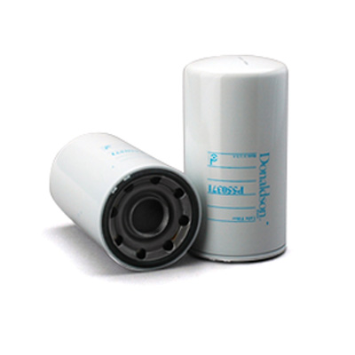

I use the Donaldson, it has better specs then motorcraft fl-1955 and Donaldson is among the best filters (they are like cat filters)
No filter is immune to defects, I bought a motorcraft fl-1955 down at parts store in O'Riley's and looked inside to see a piece of metal that didn't get a full hole cut out. Took it back for another one and they swapped it out so I look at all my filters now.

How expensive is that donaldson? I have thought about switching my superduty over to one of those for a while now but the only ones i have found have been extremely expensive, upwards of 80$. They are larger even than the FL1995 motorcraft right? Any issues fitting them on a N/A 7.3?

The white Donaldson for 7.3 powerstroke is same size as the fl-1955. The Donaldson blue is the massive one that may or may not fit.
As for price I paid about 20$ for the white Donaldson and it feels higher quality then the motorcraft. It certainly has better specs

I had looked these up. Donaldson is 99% @ 17uM, Motorcraft is 98% @ 18uM. Its a slight difference but its a difference and the price isnt that much more. I am going to see if my local can get them. It would be interesting to see if the big blue filters would fit our trucks.

This is the one I was looking at getting. Spec is 90% @ 10uM. That is a huge improvement.
It is also 3.5" longer and .5" larger in diameter. That isnt MUCH larger around but it might hang down a bit.
