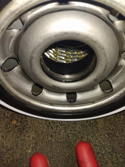

Just wanted to share this. It's for a 15L caterpillar diesel. Napa gold made by wix in USA. Only about 3/4 of a thread to hold it onto the engine.
Napa brought out a replacement for it and it had the correct threads. Imagine if I had put that on without noticing! Thing would have blown off on the road somewhere.
I usually like wix.... Little worried now.

I nave seen that, but I have seen two that didn't have any threads at all. Oddly enough, they were both for IDIs. The first was brought in by a customer for us to put on his new engine. I filled the filter and tried and tried but couldn't get it to screw on. I finally pulled it back off to look at it. We had to put one of our own on for him. After that, I got in the habit of opening the box before paying for a new filter and checking. The second one was a FL1995 from Wal-Mart. I took it to the register with me, along with the one that I bought, and told the cashier that it wasn't any good. She sit it aside, but I have no idea what happened to it after that.

I had a Purolator fuel filter with wonky threads a while back. I was a spinning and a spinning and it wouldn't grab, then I looked and the first thread was boogered. Maybe we should inspect our filters before we just go putting them on.

Saw no threads once. (Not on a IDI.) Seen cross threaded once. Both were Motorcraft filters.

Threads like this are why I say over and over on this site. Never assume a new or rebuilt part is working out of the box. It’s sad but so true. Many of us have bought and installed a new part that was bad out of the box. Making things worse is when we say rebuilt a engine or fuel system. Now you have to go back to lots of parts to see which one (Don’t assume just one.) or ones are bad.
