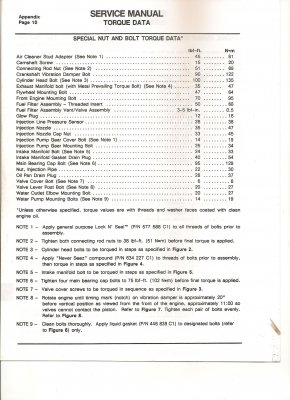

Torque is only 14 ft-lb for water pump bolts.
