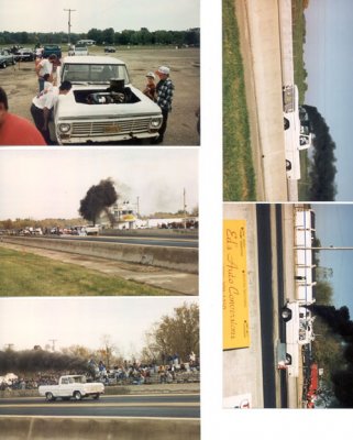

Motor built by Hypermax
7.3 block sleeved down to 6.9, twin turbos @ 147 psi, 9:1 compression, diesel only with water injection, 6" girdle, 6000 rpm, double bolted flywheel with three hardened pins, C6 trans, Strange rear end. He said that the block flexes so much that they have to use rubber freeze plugs! 1200HP IDI ran 9sec
:hail :hail :hail
As for the Cummins doing that for long, Maddog, owner of the Fummins has been making well over 1000 for quite a long time.

Who is HE and how much more info can you get from him?

That was about 10 years ago before big power diesel was the norm. I heard about it from Maddog over on CompD
