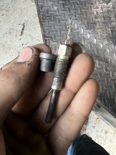

I have ten thousandths thicker head gaskets from CDD and glow plug delete.
