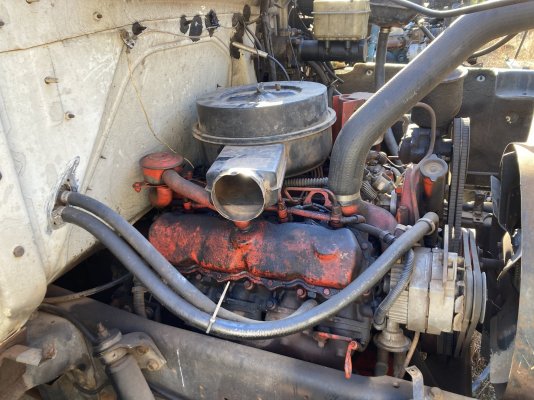

I bought an old girl, she runs pretty well, but when under load (25,500 lbs) going up and down hills at about 40-50 MPH (speedo doesn’t work) she dumps a lot of blue smoke. I’m wondering of the CDR valve is to blame. When idling or driving lower speeds little to no smoke. The CDR is located in a different spot on my truck than my 1994 F350. Is the CDR different with the IH than the F350? Or just in a different location.
I did a quick search and didn’t find this info, but if I missed something please point me in the right direction.!

Your cdr is right in the center-left of your picture. It's painted orange and is between the air cleaner inlet and the firewall.
The hose from the valve cover goes to the top, and the bottom goes right behind the intake.
It could be junk, or your engine could be wore out. Easier to replace the cdr and try again then to replace the engine.

Sounds good, any good way to troubleshoot?

Sounds good, is there a typical way to troubleshoot vs throw parts at it?
2,372
2,425
Take the cdr off, there's a small pinhole in the back side of it (in your picture it will be facing upwards) that hole can get plugged, causing the diaphragm to not work correctly. Normally the CDR is open and free flowing, but closes under a vacuum. You could take some shop air and a little rubber tip and blow into the little pinhole to check the diaphragm. Mind you only do like 3psi max! Doesn't take much to compress the internal spring. If the diaphragm isn't torn, just clean it up and put it back on.
Thanks!
