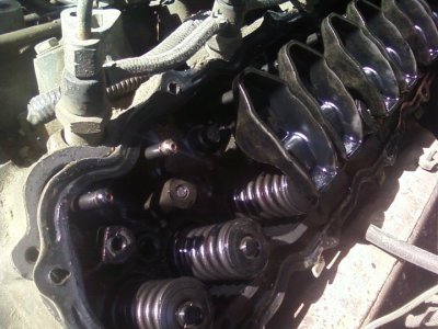

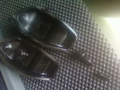

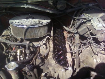

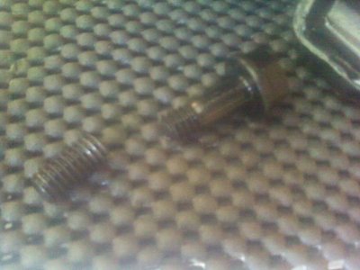

Figured I had better share some of the carnage from a mud bog I was in a few months back.

No hydrolock, just 4500+ rpm, odd thing is it finally popped while it was idling on the sidelines

thats the thing once a metal is stressed past its limits or fatigued it can fail at any odd time. so you gonna replece the rocker and try to just keep going?

atleast it was the easy side to get the VC off. lol
I know thank god!
So you put in a different govenor spring but did not compensate with stiffer valve springs?
Yes as you can see
Replaced the bolt and the two pushrods, been goin for 2 months since then

No offence, but you aren't. You're reving it 1000 RPM past the last of the usable HP. Look at any IDI dyno curve. After 3000 RPM, it's all over but the carnage.:D

No offense taken because I fully understand that, I also stated why it is run that high. Just wish I knew of some valvesprings that would take it.
