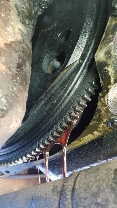

The original factory C6 torque converter drain on my motorhome had a drain. It was hiding in the small hole above the one with the stud.

Having trouble finding the drain plug in the torque converter. Any advice? I’ve read allen key bolt and/or 7/16 hex bolt? Knowing what I’m fishing for/with would help.

Mine was a normal hex head. I don't remember the size. Dunno what notch you mean.

Just keep rotating it til you see it mine was 7/16 hex
