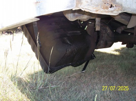

So I do wonder, what tank it is that I have? Thought it was a 38 gallon, but may be smaller, and it is plastic? So… wonder what size it really is… has a skidplate which IMO is a must, especially in the precarious places my trucks wind up in… would hate to punch a hole in the bottom of the tank… that would be bad…

The only plastic tank I've found in the bricknose/OBS is a rear cab&chassis type. I still have it. More cube-like than a pancacke. It fits between 34" frame rails, whereas the pickup/bronco frames are ~38" wide.

Well that truck that has that tank is in fact a c&c. Probably won’t work in my F250 then?

Not a direct fit, but it could probably be cobbled in there somehow.
The one i have wouldnt be a volume upgrade.
