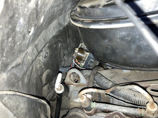

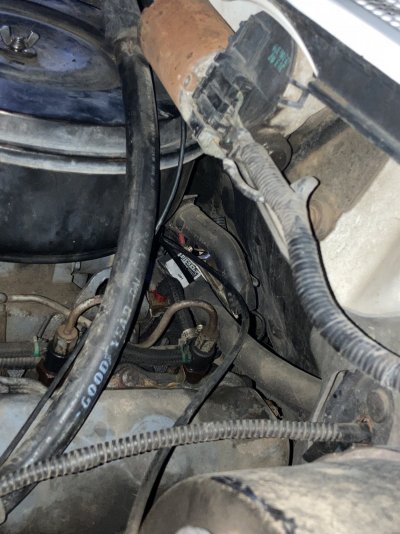

Okay so I’ve discovered that I don’t have the issue if my intake filter housing is not on the truck, the moment I put it on and tighten it down, it clicks. If I don’t tighten it down all the way, it won’t click. This makes no sense. There’s no contact happening between the relay and the filter housing, but my relay isn’t mounted to the motor as I see in some peoples trucks. Mines just sitting in the back chilling with nothing securing it down. What am I not getting?

Cubey
Van dweller
Oct 18, 2017
4,143
1,628
USA
The
The relay on it can go bad and needs to be tapped or otherwise disturbed to make it function. It might just be a coincidence that it works as soon as you disturb it again. The one on my F250 was going bad and had to be hit with the plastic handle of a screwdriver to make it function.
You can replace just the relay on top of the controller.
This is where it should be mounted:

The
Awesome, thank you. Is it a bad thing that it isn’t secured to the motor? I’ve looked back there and there’s nowhere to mount the controller. I’m not too crazy about the idea of it just floating around.
It sounds like the air cleaner housing is causing a short or open connection on the controller when it is installed. I would carefully look at what is happening when the cover is put on. On your model year truck the controller should be mounted on the passenger side valve cover.
It should be able to be mounted. Have a closer look, there should be mounting points for the controller in that area. You don't want those terminals to contact anything metal or sparks will fly and wires will fry. You might notice the plastic wire sheathing running across there in my picture, that's my throttle cable because the plastic coating is cracked up and it's a cheap way to prevent the steel cable inside from contacting the glow plug relay terminals, which can happen on these trucks if you don't keep the cable insulated.
Ah, ok nevermind what I said above then about it mounting behind the CDR. If your wires are back there, I wonder if someone replaced the harness with one from an older truck due to a mishap with wires getting fried from something metal contacting the terminals and just left it dangling there. If nothing else, I'd wrap it up with a piece of bicycle inner tube, a roll of cheap electrical tape, or anything thick and insulating that won't fall off, to protect those terminals from coming in contact with something metal.
