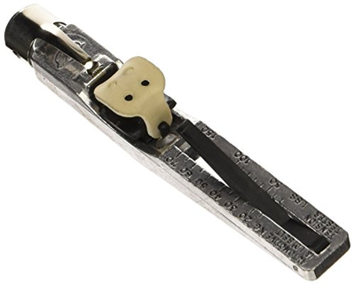

Sounds fine to me. The alternator belt needs to be tensioned. Loose belts are subject to being thrown off the sheaves.
I use this tool to check belt tension:
Belt tension should technically be 72 pounds using the above gauge. Might as well check and adjust them all. If you can't get 70 pounds, as tight as you can get them as close to 72 as you can get. I had to make a tool to get the vacuum pump belt to 70 pounds.
