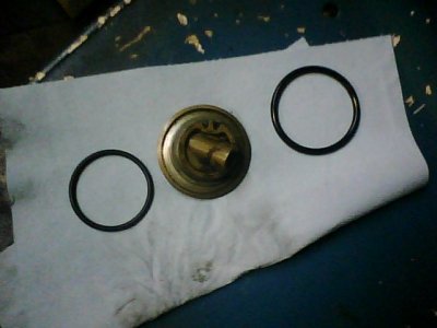

So I carefully cut a section out of the oil pan and started retrieving my lost parts... and have another question. the oring that sits inside the pan that I got from ford is much smaller than the one I retrieved from in the pan. Is this oring updated at this point, or was the ring I retrieved from something different, or has this particular assembly been rigged together before? here is a pic - new one on the left, stupid potmetal thingy in the middle, old one on the right.
lotzagoodstuff
May 19, 2007
2,728
Carmel, IN
The o-ring you retrieved from the oil pan is most likely just swelled from being completely exposed to hot oil. It is very common to have to stretch a new o-ring over a thread when they are new.
Put it together, it should be fine.

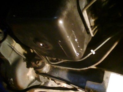

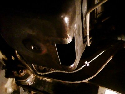

take a pic of the hole in the pan for us? be a good reference on where to cut in the future for others..
Slick
fsr7
Aug 4, 2006
299
Boulder
Ask and you shall recieve... here are the pics of the hole and the patch, it went alright... I flushed the pan with brake parts cleaner and ran through it with a magnet after cutting the hole, it was clean in there before the weld job. After the weld, I flushed it with three quarts of oil, then with a gallon of diesel fuel, then another two quarts of oil... then filled it and changed the filter. No more leaks on initial startup, hopefully there is nothing left in the pan to play with important stuff :hail I'll certainly repost if anything catastrophic happens to this engine.
