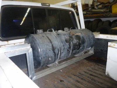

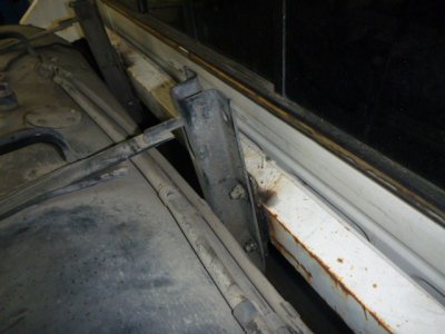

actually, this one was robbed off a generic 90's Isuzu, UD or Hino cabover. totally DOT legal. 35gal cap. Local wrecking yard gave me three of them :D
