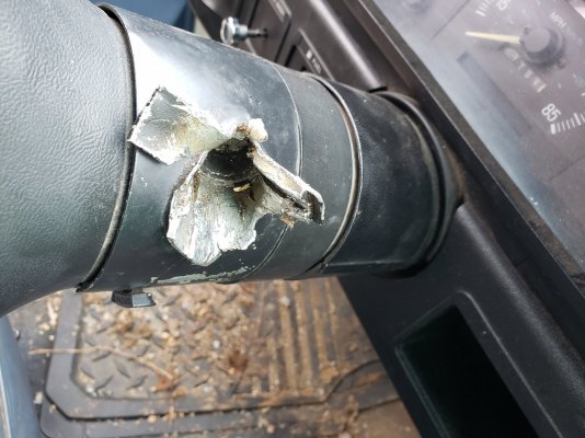

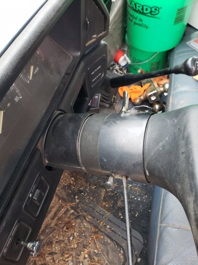

Not sure where to put this but here goes. Last night someone spend an hour inside of my 1988 F350 7.3 IDI truck trying to steal it. He destroyed the lock key way and housing so my question is where can I find a replacement steering column housing where the lock cylinder mounts? I found new key cylinders on RockAuto but nothing about the column.

Try bronco graveyard or lmctruck.com, Google them ( I'm on my phone). Sorry to hear

I had to do that to my old ignition when in Mexico a few years back. I now have a toggle switch for my power and a starter button, also another toggle switch for my lift pump.

Thank you for the replies. I too have thought about adding a hidden kill switch to my trucks and am working on a design now. As far as the parts go I found a replacement key cylinder and keys at O'Reilly's today and was shocked that they had it in store. The price was less than $20, another shock. The replacement housing is proving to be more elusive though and I tried the bronco graveyard and lmctruck.com but neither has that part listed.
I have emails to two other sites but have heard nothing back yet. I will keep you posted and will keep checking back here in case anyone has any more ideas. Thanks again.

Have you tried : https://car-part.com/ GW
