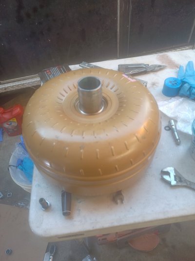

I am guessing that the pilot snub is stuck inside the flexplate. I need some suggestions on getting it out. I have tried air shims between the flex plate and the converter. hammering it. Using the input shaft as a leverage. I cant seem to get the thing off. Im about to grind the converter in half and cut that pilot snub thing off. I have the r&d flexplate so im trying to save it. yes ive taken off the 4 bolts.
The thing is, the input splines inside the converter had broken off the turbine and its free wheeling. I think it might have expanded that snub inside. sidenote, dont use transfix. I think its the main reason it sheared off inside. it was very cold and the additive made the atf thick. once i hit 3rd gear, i no longer had power to the ground. the led brake lights probably didnt help the torque converter either. it would unlock and lock everytime the blinker was on.

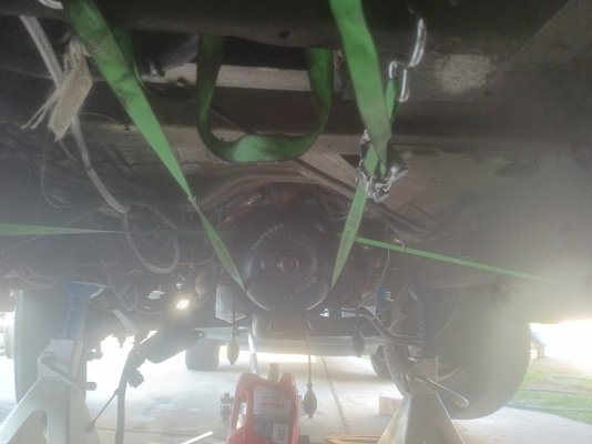

The transmission is out yes. I'm upgrading all the parts to 4r100 specs with triple disc converter. I'll find a tight fit pipe. When I put the input shaft in there, it feels like it's not grabbing anything. The flex plate can bend like an 1/8 inch away from the converter.

Not sure how bad I'm damaging the rear main seal or something in the engine by yanking in it like this but I'm sure it's not good
