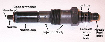

That screamer could very well be that the injector popped at whatever PSI, but the needle did not open all the way causing the fluid to scream past the opening. I've had that happen when the needle only opens a couple of thousands and your still pumping fluid thru it. At least that's what I think it is, cause I found that the needle was hung up when I went to adjust the pop pressure and had to work it out. The needle clearance is so close, I think a fingerprint will hang them up. :D
