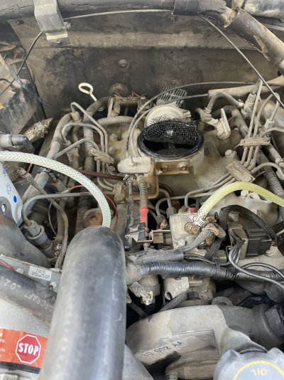

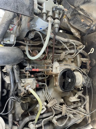

Okay so I’m having some trouble with air induction and looking for guidance. I have a 93 f super duty with ambulance package. I originally found that it was leaking a tiny bit in the filter housing where the fuel heater pokes through. I ordered a new heater and replaced and it still leaked a wee bit. I pulled it again and did a hillbilly fix and put some pipe tape in o-ring groove then put o-ring back on and I no longer see a leak there but I still have air running through clear lines. I do not see any visible leaks following the fuel lines back to the single tank that was installed when fire department put a flatbed on it. The pictures are while truck is running

New does not mean good. Do either of you have any slight fuel dampness around the injector caps on top? A slight fuel dampened area means there is a place where air can get in with the engine off. Check all your hoses on the injectors, as well as around the injector pump, especially any return lines like the one off the filter head. Any wetness around a hose clamp is a air leak.
