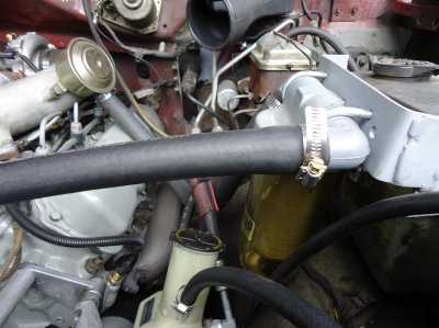

I ran a catch can using a Goldenrod filter between the Banks adapter and the CDR. Goldenrod has a stainless strainer that can be used in place of the filter element. I added a stainless pot scrubber around the strainer, done after this photo was taken. I am catching quite a bit of oil. Some still makes it to the turbo, but not much.
I was wondering how you were affected by the fire. My neighbor's parents live in West Point.
Edit: Rt click on pic and select "view image" to get a better size.
I like that filter setup, went back to improved cdr setup on mine (better hose) and will get a new one soon. and we live right along one of the three rivers and it burned all the way from where it started in amador county line and jumped over to calaveras and burned around the areas of moke hill, mtn ranch pretty good and was making a break towards west point and jumped the south river and a dozer line but the second line held it off from going any further. we left a few hours before the mandatory evac becuase we were ash and debris such as burning bark and leaves at the house, had one spot fire also lost a building on the other side of west point. whats your neighbors parents name if you don't mind me asking? probably know them
