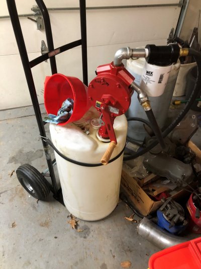

I have a Fill-Rite hand crank pump just like what Never-Have-I-Ether is looking at, and so far it has worked OK. I did have a problem once when I think the gasoline separated from my oil, and it was cold out. It seemed really hard to crank and it started to leak out of the seals (ie where crank handle went into the pump). I emptied the 15 gal barrel with it like that and changed the hydraulic filter. It seemed to pump better and honestly, I don't know if the filter was plugged or the oil was too thick. I am planning on buying an electric pump to pump it and filter it with some whole house filters. Something to keep in mind if you are worried about collecting: That Fill-Rite barrel pump pretty much needs to be screwed into a barrel or fuel tank bung. Some containers many not have that bung available. Also, I dislike the mess it makes when moving from barrel to barrel because the oil drips off the pickup tube. Also, I can't suck it out since I have a filter on mine. I am also upgrading the nozzle to a regular fuel dispenser nozzle because I have had oil dump out all over my driveway and my feet, even though I thought I drained it all out. The nozzle should have minimal spillage. Hopefully my experience and thoughts help you find a suitable pump!
