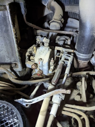

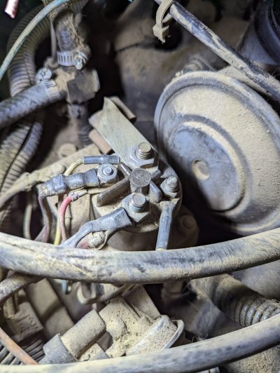

I picked up a 94 E350 Camper RV that was used as a Show Mobile to display clothes manufactured by Born Free, it was last registered 10 years ago, it has a IDI 7.3 non turbo, I took it to storage as I didn't want to get the neighbors pissed off about how lt looks
I went with some fresh batteries and had to trigger the starter with some pliers, engine appears to have even strokes during cranking, I'm suspecting that it's out of diesel as I cracked one of the injectors line open and it was almost dry without any pressure
What do you guys recommend I try, test and look over? I hear the glow plug relay clicking on then shutting off and on after a few seconds, I'm mechanically inclined with gas vehicles and can swap out parts if needed. Thanks in advance

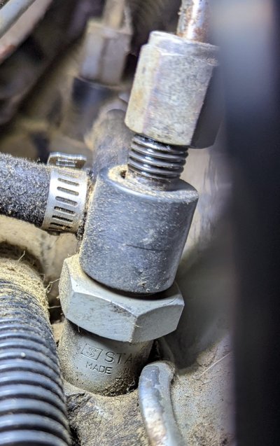

4) It sounds like the glow plugs are working. It should click on for 10 seconds and then cycle. If you can plug in the block heater as a backup.

Why are you having to jump it with pliers? Are you getting 12v to the fuel shut off solenoid on injection pump?
dfwrotary
Feb 5, 2022
Dallas TX
Thanks for the tips guys, I'm having to jump the starter because it's not working from the ignition switch, I suspect there's a kill switch somewhere? I also have some type of little box below on my dash with 2 tiny black momentarily buttons, I'm thinking something to do with the glow plugs? I'll take a picture of it next visit to the storage

If you have access to 110v power and the block heater cord looks good, I’d plug it in and help your chances of starting easier.
