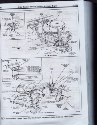

This may help diagnose your vacuum problem. Diagram is out of a 89 shop manual, but the 92 shouldn't be any difference. The vacuum reserve can on the drivers side is for cruise control, but also for one application of the brakes if you loose the vac pump.
