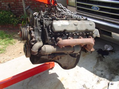

Well I'm glad you understand these engines weigh lots. They weigh around 1000 lbs dressed. That means an engine stand that is say 1500 lbs capasity really can't "safely" handle that weight. For most of us we rent the engine pickers from rental yards. Or take the front clip off so you do not have to lift up over the radiator core support.

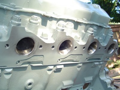

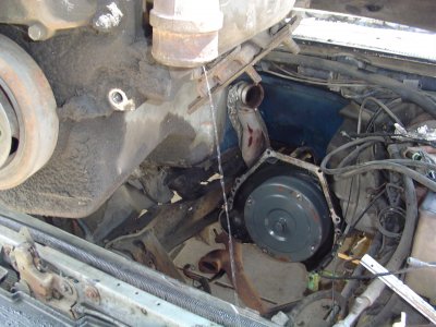

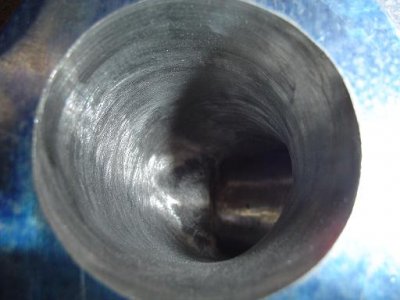

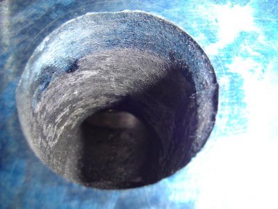

All is going well, Got the radiator removed and the radiator support out too as well, that was a real ***** because the front two body mount bolts were pretty damn seized. I have a few questions and concerns i want to ask on here.
I found some gunk in the lower hose, and it didnt seem to be inside the radiator. The radiator still flows nicely when i flushed it out and here are a few pictures of what I am talking about and I want to know whats going on. Next I wanted to ask what are some good mounting points on the block for the hoist to attach to?
