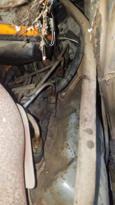

A shot of the RH lines on my 85 E350. The furthest away is #1.
Is that with the trucks too? I know van lines in general supposedly use number 5?? As the adapter line?
I'm going to try my truck 6.9 line (people on Facebook said I bought a 6.9 line) without said adapter to see what that does....it does seem the be sitting higher up which is why it's hitting the IP pumps inlet but it's also not able to clamp into the line clamps

Yes, 6.9 trucks lack it too. My 87 F250:
The shop that did the timing on my E350 used the #1 line for timing, if I remember right. #5 is third back on the RH side so that would have been hard to reach from the hood side.
