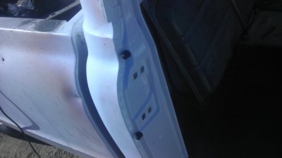

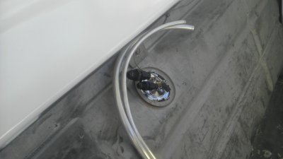

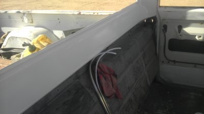

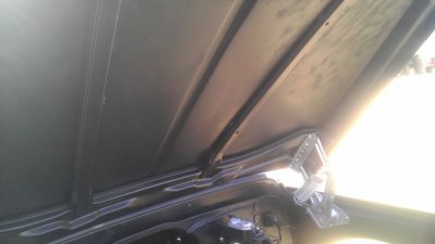

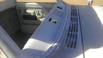

Here are some more pictures. I got the grill painted the hood painted and installed. Got the door sill/pillars painted and right floor board coated. Inside is all painted dash headliner and back wall. Fuel lines almost done need both AN 90 deg adapters to finish the hook up. I need to paint door and fix sill plate on driver side and paint it. I also resealed the roof drip rail.
