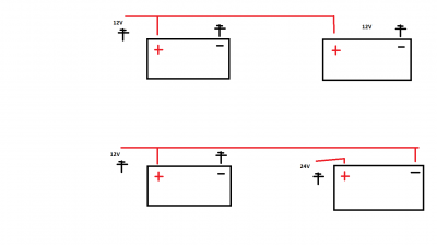

I appreciate all the ideas guys and I plan on implementing something if I cant pull 24V from my second batt. I really want some opinions on if I switch the cables like in the second diagram will it burn my truck down. It would be temporary just while I use the winch so it will just charge like normal every day.

As long as nothing else is hooked to that positive terminal,i dont see a problem. If it were me and I weren't going to use a transformer or mod the winch, I'd find a double pole, double throw switch and do this:
It just removes the possibility of screwing up something while you are moving cables. Open the hood, flip the switch and happy winching. It will need to be hefty to deal with the starter loads.

I will test it out by removing the power lead at the starter solenoid and see if it stays at 12V in that config.
I looked at your diagram a little more closely, and it's basically the same thing I had, only done a little differently. If you want 24v to just run the coils, you can get one of these. They work well, I used one to get 12v on a 6x6 military truck. We ran the trailer brake control, trailer lights, and dump bed lights with it, and also the tarp motor for the dump bed with it. All that was added on and was 12v. The rest of the truck was 24 volt, including the alternator.
