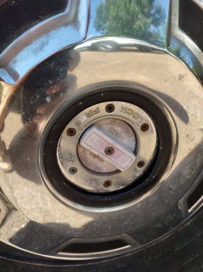

Hi guys, been searching eBay for the original dog dish hubcaps for awhile and finally bought a great looking, non dented pair that still has all the black paint. The rear ones fit great, the front ones with the cutout for the axle are too narrow to slide over. Was there a bunch of different sizes of these or is there a particular way to make these fit that I can't see?

I'd have to guess that they came out on a truck with a different front axle and had smaller diameter hubs.

The Dana 44 lockouts are smaller than the Dana 50/60 Hubs. I would say yours being an extended cab, that you have a D50….and the truck those came off of had a D44

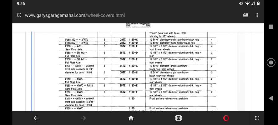

That is definitely true. I ended up finding this online last night, if anyone else is in my shoes someday hopefully this helps..
