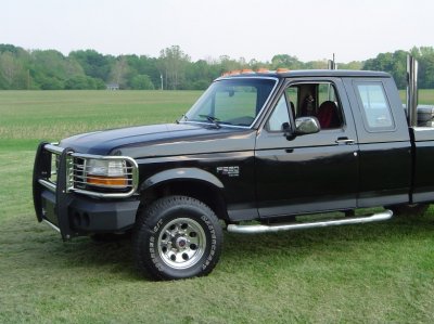

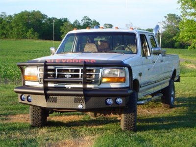

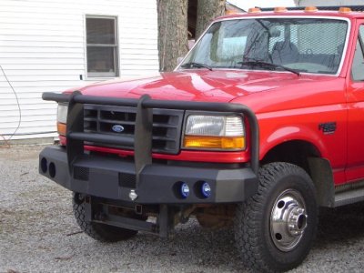

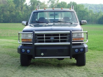

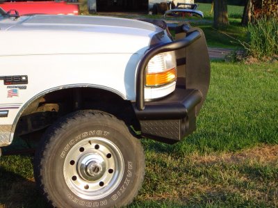

heres a few pics of a few I've built. The one on the red truck is 1/4 plate no frame work no need for one depending on how you build it. The pipe is 2" sch 40. The one on the black truck is 3/16 plate still no need for frame work its plenty heavy enough. The one on the white truck is 1/8 diamond plate which needs a frame work or bracing and the pipe is 4" sch 40. I used a lincoln110 wire welder to tack the stuff together then used a lincoln stick welder to weld it all up till I got a new miller 210 wire welder now thats all I use;Sweet

:hail You are my hero LOL. I'm so going to build up one of those for my truck, without a doubt ;Sweet

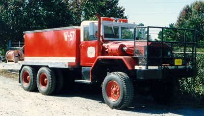

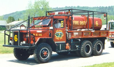

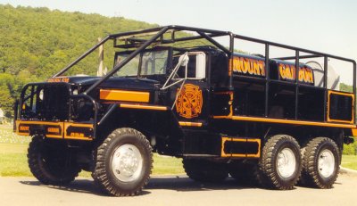

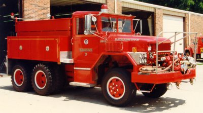

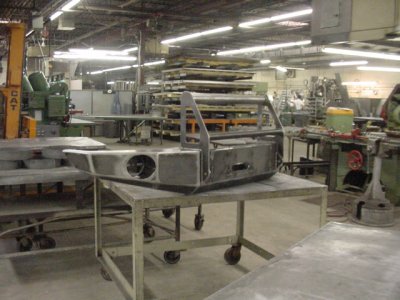

Here ya go.......Little overkill...

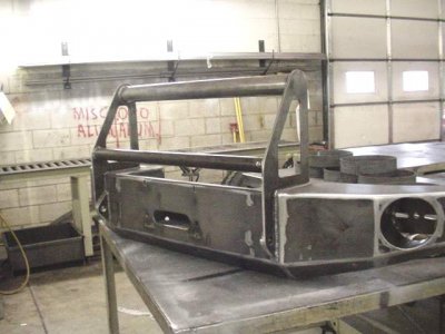

Might as well put my cow catcher up here...
My buddy made this out of two 1/4" hunks of C channel & welded em together with a 220 MIG. He mounted it on a 86 Chevy fullsize mud truck & used it good. Then they pulled it off of there & stuck it on a 83 Toyota pickup. He wanted to sell it so we pulled it off the yota & welded it 365* around my frame rails with a 220 stick welder & 7018 rod. You can jack up the truck on that bumper it ain't going no where. I still have to weld on the top & side plates one of these days.
Recent pics of it painted....
The things on the bottom were for a tow bar setup on the yota.
How far it sticks out....
I like to lay a hunk of plywood across the rad & on top of the brush guard & it makes working on anything like pump, injectors, glow plugs a breeze. Can't beat the platform to stand on either! :D

That looks simple enough to make - I'd put a front hitch on it and rig up a tire carrier....
Hrm. Too bad steel is so damn 'spensive these days
Cat_Rebel
Does not compute
Oct 11, 2007
724
Wouldn't you like to know
I have a weld on Reece hitch that's gathering dust, was supposted to be installed since about Febuary. LOL
Just need to get together with a good welder & mount it up. I left the tow bar slots on there to help protect the rad.
What I'd do is talk to as many people as you know & see if any of em have something 1/4" it be C channel, 4"+ steel pipe or you can even make an I beam work if you have a way to cut it (torch, prinder, plasma) & put some thought at it.
Oh yeah by the way get another person, that stuff is just a tad to heavy for one person to throw around. Don't ask me how I know.....cookoo
