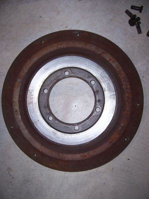

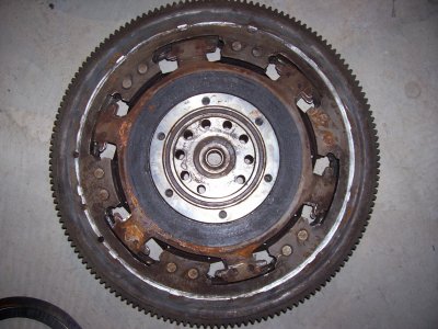

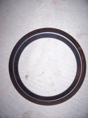

DMF internals picture's
Okay, here's pictures of the inside of a DMF. The two small round pieces are the overload clutch. Made of spring steel they are convex and clamped in the center of the clutch face and backing plate. Once these spring plates have been slipped enough to overheat they are shot. You can buy the bearing, springs and bumpers to rebuild these if you clutch face is good but I'm not sure about the spring plates, I don't remember seeing them separate anywhere. I have been thinking of rebuilding this one and selling it, its not the right one for my 94.

Thanks for the pics. What I'm gathering from this is that you really do not want to mate anything other than a stock clutch up to a DMF, because if you put a super stout clutch up against a dmf, you instantly make that little slip goodie a functional safety release that you don't want to happen ( the weaker point of friction releases where I bet it's calibrated to be the stouter of the two with a stock clutch).
Kind of sounds like I'd better go with a solid flywheel, as much as I'd not like the noise. I pull too many heavy trailers and just getting them parked at my place can be an interesting chore.
