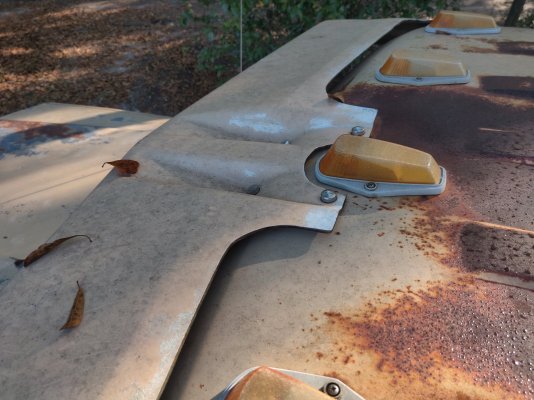

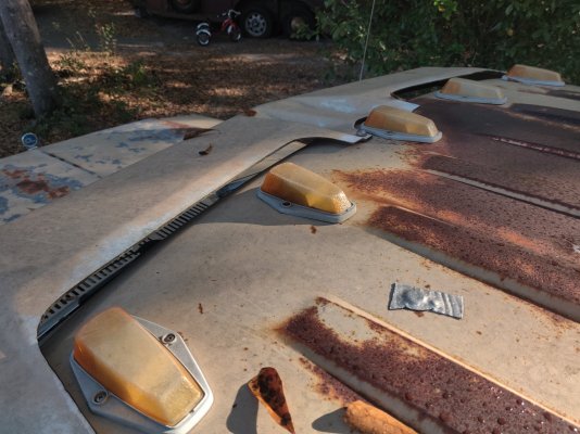

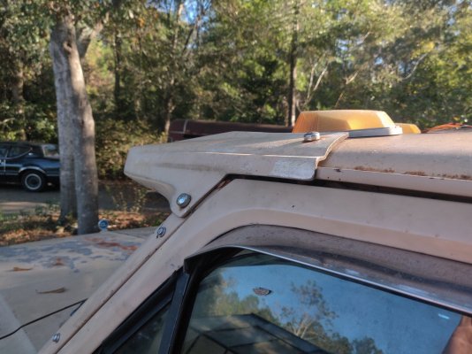

That cab visor part # is:
LUND MPLS MN 55433 PN FP2
eBay has a listing for one that’s for a 1980-96 f-series but these gaps don’t look quite right to me. is there a place that I can request other cab visor reference photos?
That's the same viser I have and that's how it fits. I'll take pictures sometimes today.

I think you're legit.
Thanks for sharing those pictures! Yours looks good.
What did you use for your fasteners?
Have you noticed any premature rust or leaks from the holes?
I was thinking of using fasteners like these: but shorter

That's basically the screws that hold it on. It was there when I got the truck and it did leak because of rust around the screw holes. I pulled it off, cleaned it, and applied a gob of silicone at all the screw areas.
Thanks. It Sounds like maybe a hood coating of rustoleum on the exterior and interior roof sheet metal is in order before I install it.
