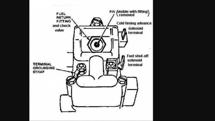

I’m interested in understanding this better. I don’t have any knowledge of what goes on inside that pump. Can you explain why a check valve would be beneficial on the return port of the IP? Currently I don’t have any check valve on my system
The factory return fitting on top of the IP has a check valve in it.
James
13,325
3,898
the fuel in the bowl has a check valve to release excess pressure

All the check valves you need in the system are already present.
There are 2 in the mechanical lift pump, and 1 in the injection pump. Any others added would be redundant and unnecessary.
