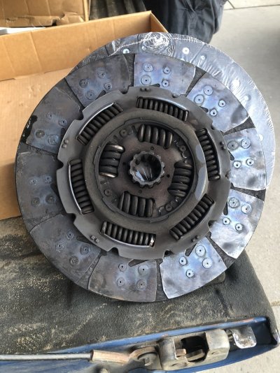

I removed the down pipe. Removed the rest of the bolts and the trans came out like it was on greased rails. Here is a pic of the clutch. We came back from northern Idaho towing my Jeep. It never should have made it.

How in the world did that thing even work? Do you have to replace the flywheel too? Since I'm going to Taylor Park over the weekend, I was going to offer to stop by and take a look, but you got it without me.:cheers:

since I had no idea what was in it, I purchase a kit that has everything. Flywheel, clutch, pressure plat and all bearings. I also purchased a new clutch fork. Start fresh. The trans has been replaced at sometime as there is yellow marker on the drain and fill plugs. It is very tight and shifts smoothly.
Clutch material is for those who don't know how to drive a truck :peelout
Mighty impressive you made it home, cause you have NO clutch material!

I agree. We could have been stranded in the middle of nowhere very easily.

Now that's impressive, good job!
