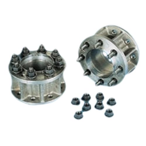

For the the front axle, you will need just the drw hubs. I did not get them with mine, the prior owner was a sticler on cost and was the only way to get some off. I am using the hubs off a d50 to get srw and ball joint d60 ones for the obs should work, not sure on gm or dodge having the same spindle and the sd got disposable hubs.

Rear axle is wider for a drw dulley and a cab chassy drw is a narrow frame, so springs are more inboard. You might get away with 2-2-1/2 spacers, but would recomend steel one if you go that route. Im not sure on space to leafs for drw wheels to fit but you could set one in place to see space needed. Also 2wd drw dulley vershion might be found at a local yard to get one to swap, since is same spring width but you are more likely to find cab chassys that wont work.

If you dont mind welding perches on new spots, the Dana 70 from an e350 cube van is a similar width as the drw pickup.
I dont like rear dually spacers if increased payload is the objective. They add to the leverage on the hub bearings and spindle.

Front dually spacers i can get behind. Thats OEM on newer trucks. The spacer and the dually-offset wheel cancel each other out for no adverse effects on the wheel bearings.
