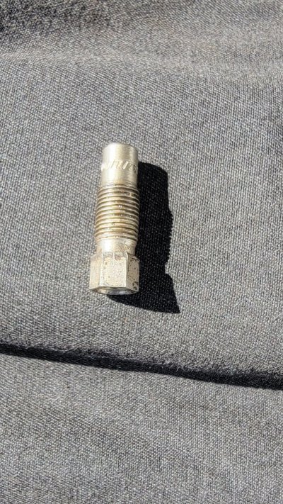

Alright. Here we go...

Well everyone... What do I do.

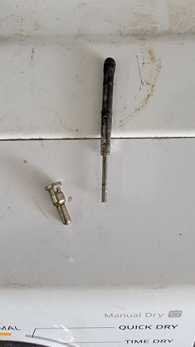

For future reference... Very good vice grips and a prybar for leverage to pull it straight out. I didn't want to pull the head.

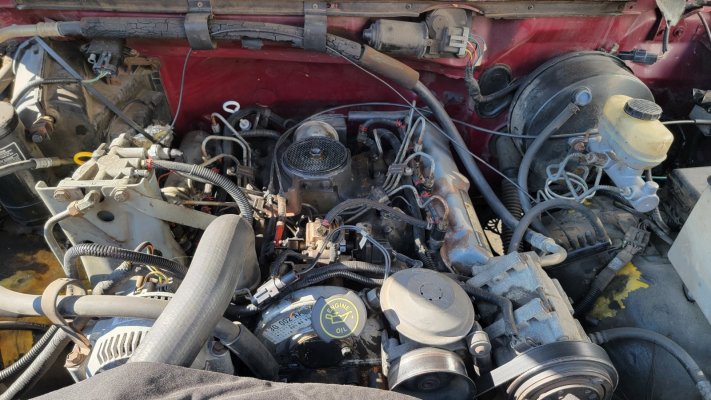

Well I'm over here pulling my hair out. Trying to use this dang DTI timing tool, but the dang light isn't flashing! And insult to injury I can't find the manual.
Still smokes heavily when revving up in neutral. Doesn't smell of coolant, but I'm sure timing is still off.
Pump and injectors are all rebuilt, all glow plugs tested good. What am I missing?
