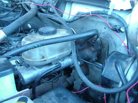

Russ, I just sent you a PM on FB before I read this. The hydro bore is too large? Mine is marked at 1 5/16. The vacuum unit it replaced was 1 1/8. Re the mounting holes, do you mean the holes through the firewall? I don't recall having a problem. The 4 studs slid right through and tightened down. Is it possible that I have a poor hydro unit?

MAster cylinder mounting holes
