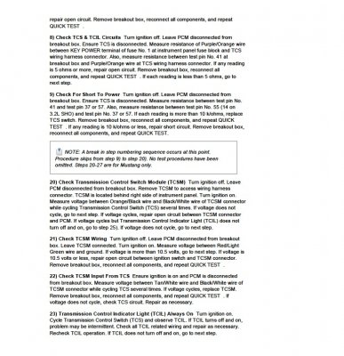

Hopefully this can help
Sent from my SAMSUNG-SM-G870A using Tapatalk

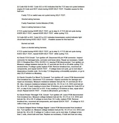

Forgot to put the first page on testing it

All fuses and relays checked out good, I unplugged the OD wiring from shifter and it goes down into first gear and shifts all the way to OD, but acts like it goes into neutral sometimes
When in OD, and ordering a new shifter lever with the overdrive wiring, hopefully this will cure the problem
