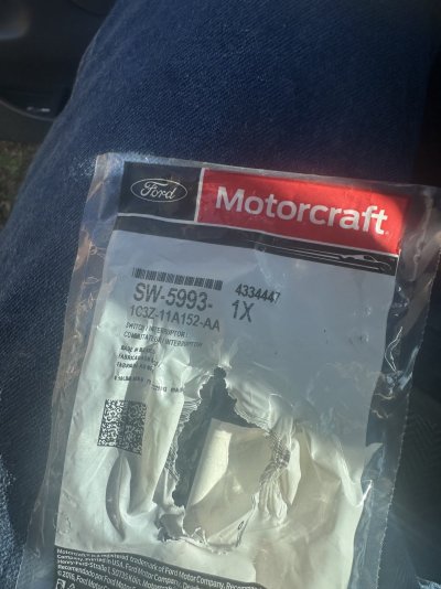

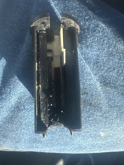

so the previous owner bypassed the clutch safety switch. I installed a new one and I can’t push the pedal down with the new one installed if I take it off I can slide the piece by hand to start the truck.i can feel and see it hitting the new switch. Am I missing something. The old switch was hanging under the dash connected to the harness still. I’ve owned this truck for a couple years and it’s never had a switch attached to the lever. There’s a picture of the old one and the bag from the new one. It will start with the old one plugged back in

To the original thread starter. Here is a picture that shows the switch. The switch in the lower part of the picture is the brake switch, but up in the middle it shows the starter interlock.

I was under the dash early on when I bought this thing doing something and had to take off that switch. At the time wondered what this goofy thing was, and messed it up getting it off, then figured out what it was.
Now it has a jumper wire on the connector.

The truck came with it so I’d like it to work. Plus I’m tired of driving from Oklahoma to Washington with out cruise control I do that trip a couple times a year

The switch gets to be a problem when the pedal linkage is worn out.
I nearly had my leg pinched off between two trucks 25 years ago because a friend had disabled the interlock and it started in gear. I'll keep the safety switch thanks.
