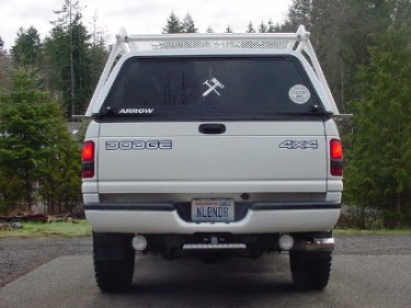

I went with tractor implement lights with 55w halogen lights. We built a bracket so we could go up through the bumper bolts and also hide the light bracket. The 55w hologen's give more than a 90deg sweep and cast light about 20ft to each side of truck at the bumper.

After reading about the White Nights, I was concerned about the difficulty of trailer/drawbar hookup. Some had modified them to help minimize the problem, but I fugured that if I was going to have to do that, I might as well start from scratch. I tow almost daily, and two or more different combinations/drawbars.
We used the utility lights shown in NB's photo, mounted to a bumper bolt, on a custom bracket. This raises the housing so the mounting hardware is concealed.
Light quality and pattern is excellent with the halogens. They are, however, the most expensive part of this method, @ $26 each.
Overall, the cost is little different than the White Night, and you get to scrounge all of your own parts and pieces. ;) I've heard of many folks that are happy with the W/N. Not a bad product, but just thought I'd offer some more details on another option.
