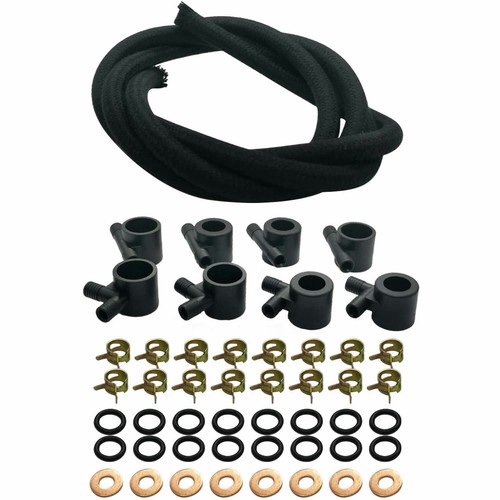

And here's a whole kit for less than $1 more. (They're $115 at NAPA now).
I'm assuming all are from China, fwiw.
I wonder if these o-rings are Viton. And what's up with the hose barbs on the caps being on the side? Mine go straight into the barrel. Which is better? Not that I need more caps.

The Hose barbs on the side is used on the 7.3 engines, Think the return hose is 1/4".
You can use them on the 6.9 engine, just need to swap every thing, can`t mix and match.
Copied this from Diesel Hub.
There are two injector return cap styles, referred to simple as the "early" and "late" style. The two styles are not directly interchangeable, however an early style return system can be retrofitted to the late style. While there's some debate surrounding the topic, the consensus is that there is little reason to convert one system to the other. The late style injector return cap was introduced during the 1989 model year to address concerns with fuel leaks. Early style return systems utilize a 3/16" hose while late style return systems feature 1/4" fuel hoses. The two styles are easily distinguishable and you can visually ensure that you are getting the correct parts for your application. The figure below will help you distinguish the early and late injector caps.

Dang. Want to send me some cash and I'll mail you a cheaper one? :rotflmao

I just checked O'Reilly's. $98 there.
I guess I'll take a chance on a $20 Ebay kit just to get 8 washers.
