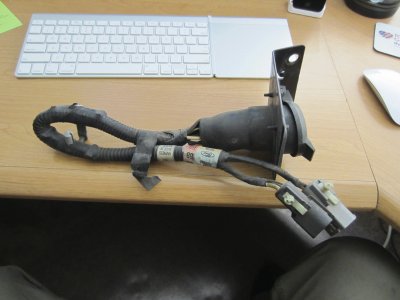

So, I pretty much gave up on finding a KO 12V source on my OEM Trailer wiring.
But I was looking to get a 4 pin harness, and a 7 pin. So, I go to Hopkins site. They list part number 40125 http://www.hopkinstowingsolutions.com/products/vehicle-wiring-harnesses/fordfseries.html
But, it no workie!
Here are the oem plugs on my 1993 F250
Here's the Hopkins adapter

These connect to the trucks wiring. You don't show the other end that is the trailer connection.

The oem plugs provide a 7 pin hookup.
I'm trying to do this without cutting ANY OEM wires. I REFUSE to use any type of vampire tap. They make P&P adapters for almost every application out there. I just can't find the adapter that fits my OEM plugs

This is what I found; http://www.etrailer.com/Wiring/Hopkins/HM47365.html

That adapter goes between the main tail light harnes plugs...for truck...not your factory trailer plugs
****** to get to dr side frame rail where goes in behind fuel tank.

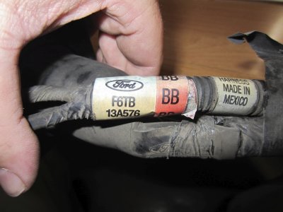

Have you checked with your Ford Dealership?

Chicken dinner award ?????
Thats what's on my 93
