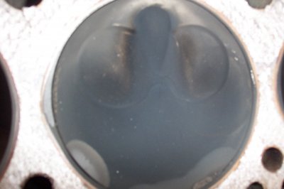

Since I star cracked my pistons and cried myself to sleep that night - last Labor Day coming home from GEO's place in North Carolina.
(room : gasp!)
(Sponsor : My my can you give us details of the ordeal?)
Well let me explain the system to ya...
One nozzle 0.17 GPM (shoot a fine mist when activated in the air out side engine compartment)
One lock off solenoid purchased from McMaster Carr that when power is applied it opens to allow flow - No power = No Flow.
One pressure sender to trigger the lock off solenoid (7psi is rated pressure but once warm can trigger as late as 9.5psi - never triggered at a lower pressure than 7psi) Max boost on an IDI 11.5 (wastegate opens - IDI's are low boost engines not like the Cummins or PSD's of the world).
One pump (pressure setting was 100psi) can't remember GPM rating on pump but want to say it was 1.7gpm...
Flip the switch and she was armed and dangerous, once boost hit correct level you would feel a little more push (not much mind you - not much at all but was there) would notice a little more "Diesel" sound from under the hood.
EGT's achieved were still about the same if you held your foot to the floor and tickled the injectors but they climbed at a slower rate.
Now pulling a load is where it really showed it's stuff. The extra push would help ya on the hills and the lowered egt's were nice (like I said if you held foot to floor they really weren't that much lower just got there later) While towing if I did not use the extra power then the EGT's were lower - but if you got it use it is my theory or was I should say...
System was installed for about 1 month (give or take) and around 2~3k miles made one big pull with TT on back (and some short runs around here locally) to NC and back (well most of the way back) about 1/2 way back she started knocking on one of the hills outside of Lexington, KY and I said the heck with it and drove home (wee hours of the morning - shut off system) got home and started looking at the carnage... Slapped it back together and sold it to another member on TDS (and here now).

Don't know how long a post you can have so here is part two...
Upon teardown I found that the edges of the swirl chamber (for lack of a better word) were eaten away by the water or whatever else - sorry I don't think I have pictures still but will look here in a minute...
Motor only had 70k miles on it - YES 70K Miles... So engine was fresh in the diesel world...
Engine was only 2.5 years old - again young engine.
All of the fuel system was new as well - actually had even less miles on it than the engine it's self. Don't truly remember that mileage as I gave away all reciepts (went with The Enterprise)
Engine was in correct time - Set by a gauge at local diesel shop.
Engine did hit RPMS that made Mel (agnem) give his classic oooo sound (sitting worried in the side seat) Red line means nothing to me... :peelout
EGT's and Boost were both always watched like a hawk watching a field mouse. Did not want to go into what I affectionally call Thermo-nuclear-meltdown.
Talked with Ken at DPS and he said he thinks I created too much pressure in the combustion chamber which took it's final toll on the engine - first thought was I was putting in too much water. Do the conversion and it comes out to 10.2 GPH you be the judge considering most off the shelf systems that are marketed for all diesels ring in at 10GPH... Me I don't know what I did wrong....
