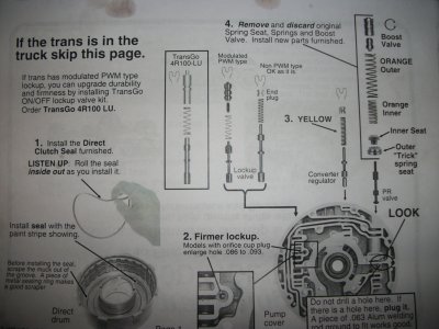

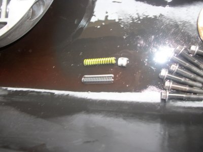

What where is this spring located. I pulled my trans and took it to trans shop but i didn't see a spring.
Its located in the pump. If you sent it out, have your tranny guy change it for you.
The reason for changing this spring is to increase the apply pressure to the clutch. With a stock spring your new converter is only a little better than the old one. By increasing the apply pressure you will get the most out of the clutch.
FORDF250HDXLT
Dec 27, 2009
6,456
1,127
Maine & Oklahoma
the "E4OD-HD2" kit that i installed in log truck (the one between the Shift Kit and the Tugger) sports the spring your after as well.it's yellow in color.
