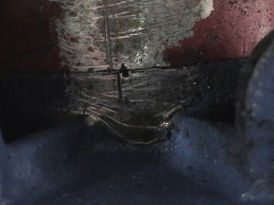

Does the timing marks look like this on the IP or close to it. The lighter mark is on the IP toward the passenger side, darker on the mounting flange,
