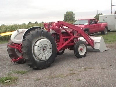

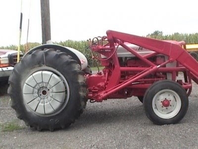

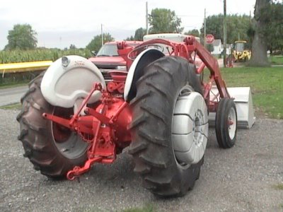

If you are hauling the tractor back and forth , buy another one, its cheaper than a new truck.
I gross out at 16.000 with the jeep on bac and or buggy trailer. loaded for a week. You are going to have cooling issues unless you lock the fan . More later
Like typ4 said. I'll sell you this one for $5K, but it's a long haul from here to there.
