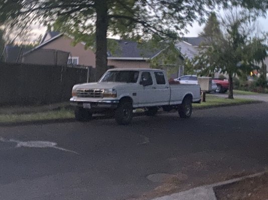

So here he sat the weekend I bought him, bought down in Mill City, OR for 1700$ with a bad trans (only had 2nd and 3rd with manual shift only) so I drove em home to Forest Grove just happy as a freaking clam.
89 lariat with a 94 front clip on it. Everything else is still that half **** bricknose build.

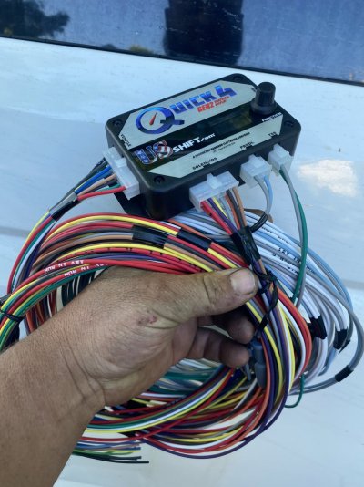

So I bit the bullet and bought a us shift quick 4 with the full kit literally everything they offer for the e4od I got.
I installed it with the bare minimum required which is all the trans connectors, tps and tss. Away I went happy to have the truck shifting through all the gears I paid for.

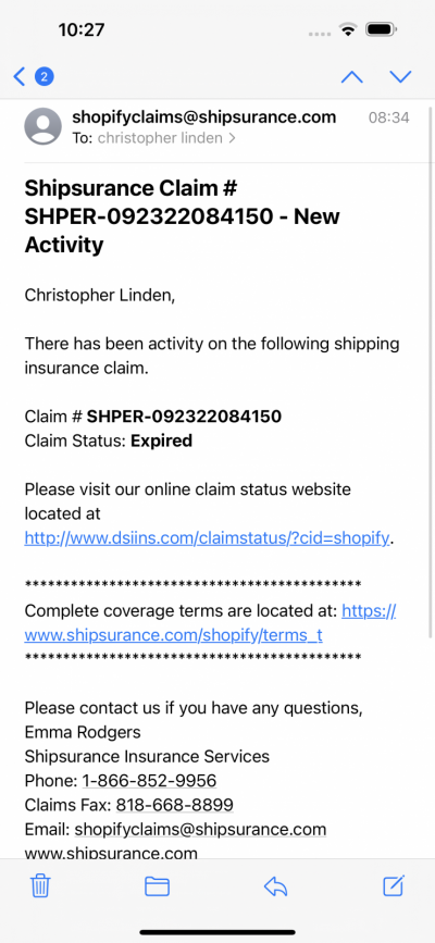

On 8/4/22 I ordered a 3g alternator kit from CDD (before I knew about the guy)
On 8/8/22 it was supposedly delivered, but this is where it gets funky. My mail carrier had not put it in the parcel locker in which it for sure would have fit in, so they sat it next to the group mail box and left( post masters story) Well I started calling and emailing Wes asking where my stuff is and eventually he started a insurance claim (was only going to cover 200$ of the over 300$ I spent on the part)
Well I filled the online paperwork out and Wes never filled his out according to his own insurance claim. I emailed and called multiple times with just bad attitude or snarky comments in tow.
Well 11/27/22 was that last I ever heard from Wes and he no longer answers my calls.
So if there is anyone in the Texas area that is willing to help do a bit of small claims court stuff for me I’ll give you everything I get from him.

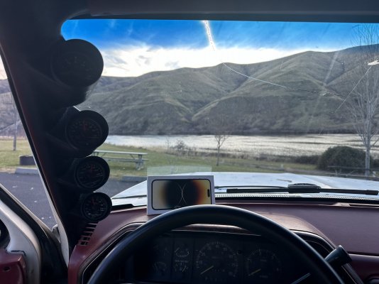

Over the Christmas break the wife surprised me with a gauge set for my truck (with my own money of course….) it is the 4 pillar gauge set from glow shift their max tow dual read out. I know glowshift isn’t that great of a brand but I actully like them a bit and love it even more as my none gearhead spouse is trying to get in on the hobby.

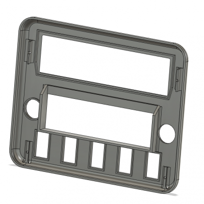

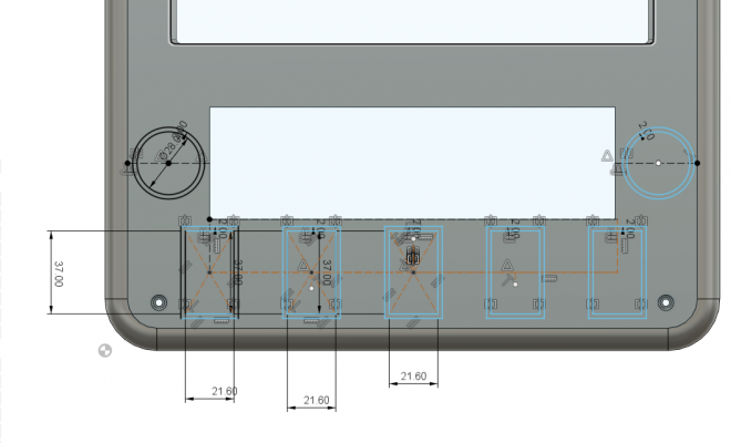

So while drunk web surfing I found a guy who makes these awesome custom dash bezels. Originally he made them to fit a bricknose dash fit a double din radio. I just asked if he could make me one to fit 4-5 rocker switches and 2 power ports l. In less then 10mins he had a fender that was damn awesome. Making it today 1/23/23 and will send to me to fit test as well as to sell possibly. It should just snap into place with the factory tabs so I pretty stoked. I’ll post here for sure when I get it

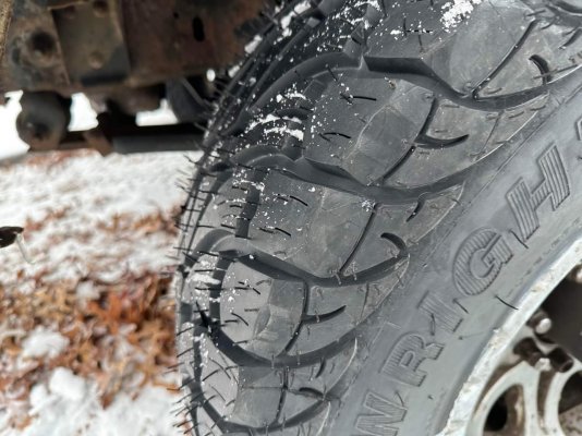

So for Christmas before I knew the wife got me gauges (with my own money…) I went and tried something I haven’t done I bought recaps (brand new)
I got on Treadwrites website and there they were, a full set of “blemished” recaps that were nearly the size I wanted for a absolute steal. So charge card came out. Got them right on Christmas and lucky when I got home from the frozen hellscape it happened to just be snowing a icing over everything in my part of Oregon. So good time to out them on.
I got 35x12.5r18s I wish I could have gotten them in a 33 as I don’t need the truck to be so high anymore and I kinda wanted to lower it back down a bit anyways. So far I love these damn tires, holding there own up in the hellscape with all the at and mts.

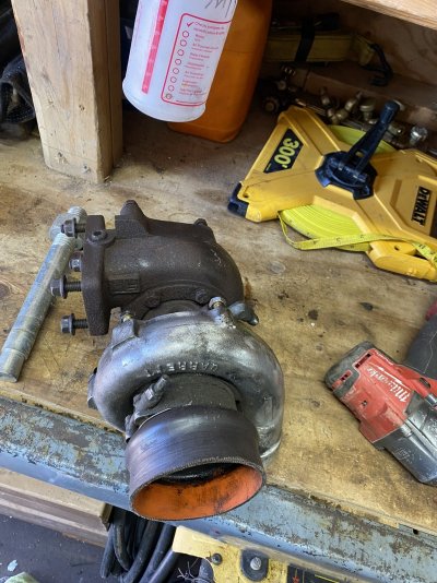

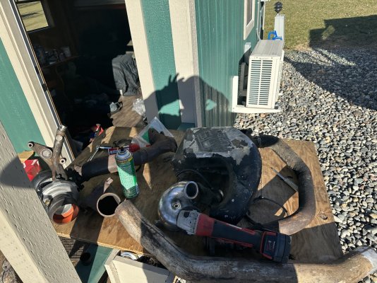

So with all this extra time I have while working so far from home I take whatever time off we have that I don’t go home to work on cleaning up this 093 turbo kit. I put some MEK on the factory air box to strip the rest of the paint off. I polished the down pipe for some stupid reason. And cleaned all the oil and grime off the pedestal and related parts. All of it is getting ready for some cerakote going to see if it will hold up like they say.

So I started with getting the gauges all wired up and that set me into one of my autism fits… so I had to go and make the wiring harness just right, which made me want to add some pass throughs to where the factory tcu was (remember I have the sweet us shift quick 4 now) but then I needed big cables to pass the power through for the inverter I want to have to charge all my chit. So a big Amazon trip later. Making sure to get only real copper lugs and real copper wire not tinned alumn…

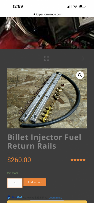

Whelp last night while pretty buzzed i through the ole credit card out the wallet and ordered more fun stuff, now I gotta get the choice made for the 90cc or 110cc
I’m leaning pretty hard toward the 110cc

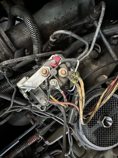

Well moved my glow plug controller today when I got around to installing my new harness from ididiesel, I will say it’s a nice kit but leaves a lot to be desired about fitment on how it sets in the valley area. I’ll be pulling my motor this year and slapping in a new refreshed one anyways so I’ll really fix the wiring when it’s out and easier to work on, I just want it to sit in there all purdy like. Won’t take long, plus I’ll make one of them brackets to put the controller on the valve cover.

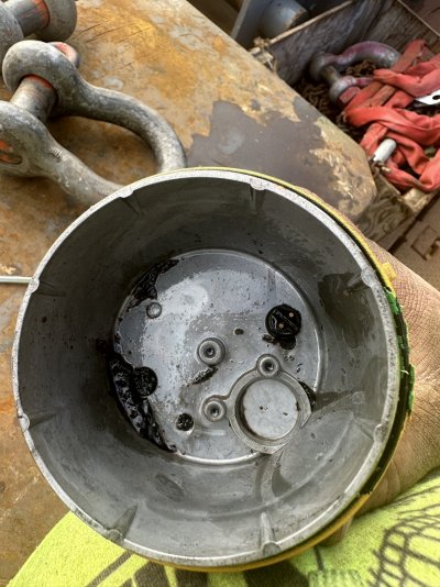

On a side note I spent the day at work doing fluid and filter changes on everything the company has on this job, and would ya look at that, the RAYCOREs have just paid for themselves on the tug we have. So dang much algae has been in there and didn’t notice, only got a low fuel pressure light last week when doin some water doughnuts but went away pretty quickly. So ya know gotta burn off or transfer about 3000 gallons of diesel so we can take the hatch off and go clean it out. If these raycores were a lot cheaper and rugged itd be pretty nice to have em in your alternative fuel setup.

Which Racor are you useing on the Tug?
I know in the Boat world, they use the Racor`s a lot, some times several in line. I have read they plumb them in for fuel polishing.
I have the 500FG on my 86. They sure do the job with that large settlement bowl on the bottom to spin out the garbage, plus the Filter up higher.
The one`s for large yacht`s are much bigger than the 500, think a 900 and a 1000 series etc...
Used the 200FG on smaller Diesels, used one for 400K mile`s.
I’m pretty sure it’s a 1000 series but I could go look to confirm, we have 1 for each main engine and 1 for the transfer pump from the main tank to the day tank. Company put them in when we were took about 90 gallons of water through the tank breathers as a hopeful way to grab most of the remaining water out, tug is new mains only have 400hrs on them
Banks shows one for their Side Winder kit and will probably sell it separately. It doesn't mount to the valve cover. It bolts to a couple of intake manifold bolts and puts it above the passenger's side valve cover.
