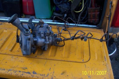

on top of the IP gear housing right by the oil fill there's a big hex head with a wire coming out of it. that's the tach sender. pull it out and clean it off, that may help.
14,778
483
Look at the arrow pointing at the sending unit on the IP I have on the tailgate of my Bronco.

I looked at the sensor and its hooked up, I didnt have time to pull it out and clean it though.
