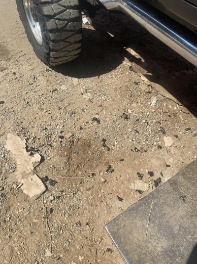

i cleaned my intake and exhaust valves with paper towels :D
91,344
1,130,730
24,143
Cv axle
