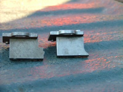

Here is a profile of a #10 plate and also a pic of a #1-- (10 and a 0 combined) off to the left of that pic is your stock plate,the one with all the different notches, its easy to grind your own and then just polish it up good, mount it all the way forward and then back it up just a touch.
