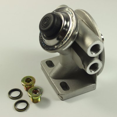

I ordered one of these filter heads from Ebay. I'm hoping to mount it where my stock one is (on the firewall). I guess it's a China copy of a Racor 490R10. If it fits well I'll see how long it lasts and if it's junk then at least I'll know that the Racor will work here and then I'll spend the $ for the Racor.
I've had it in my head that some day I'm gonna wish I had a primer. And I don't trust the stock filter that's still on my truck. So I'll be killing 2 birds with one stone if this works.

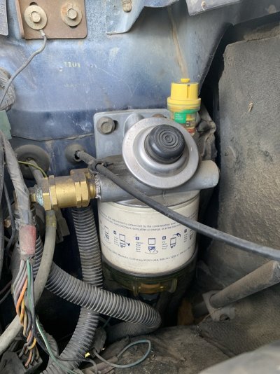

I made this conversion 8 years ago on my 85 F250. The 490R10 was too tall - I used the 445R10 as a direct fit replacement - it does a fantastic job. I drain it every time I check fluids, usually less than half a teaspoon. Below is a Cut/Paste from the Sept 2014 order - included the fittings, which all fit perfectly (I was shocked enough at the time to remember to include them here…).

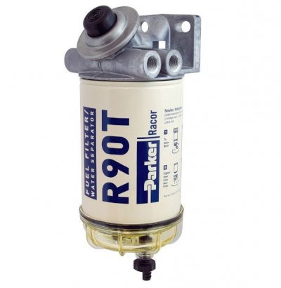

Note: The first order was the knock off R90T - which I returned - it was $120 at the time - seller was BoatStore.com. The truck is offsite or I’d include a photo… if someone needs a photo, I’ll go get one.
The primer has saved me multiple times, highly recommended. This conversion fixed all major starting and vacuum problems I had with this truck, which enabled fixing any remaining GP issues. Starts/runs more reliably than my wife’s current gen Honda Pilot…

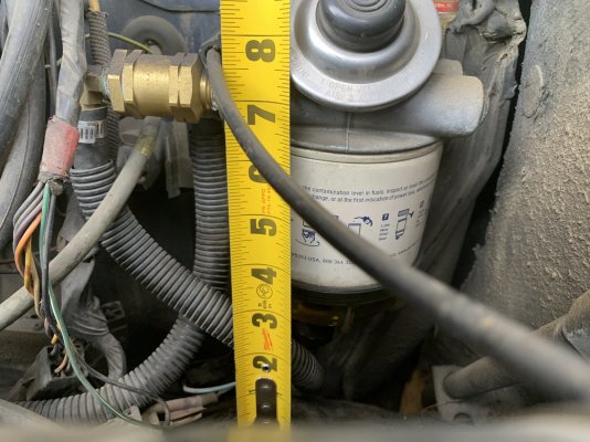

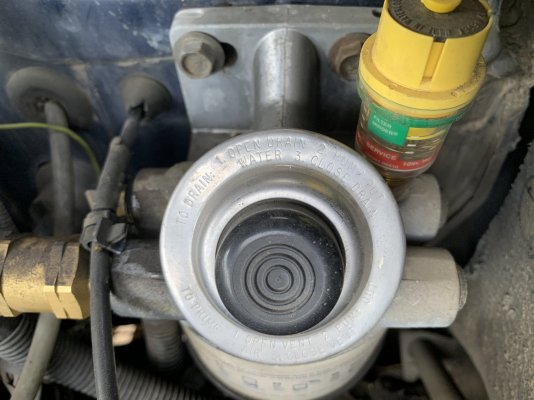

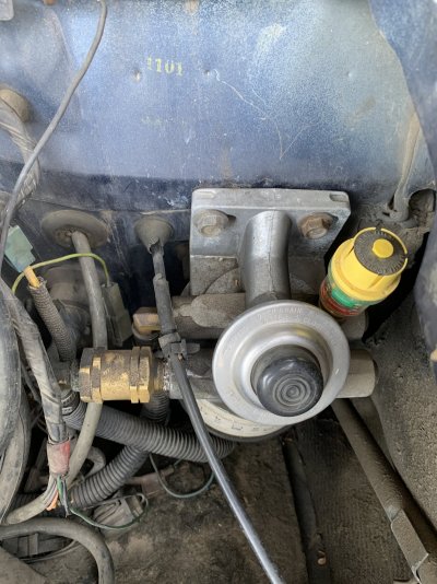

[update - with photos and narrative]
@Brian VT - Two things of interest in the photos there: 1) One of the photos has a tape measure... as best I could parallel to the front, bottom starting at the front fender. 2) I capped off the two inlets on the right (front ref pt) - so only two ports in use.
On the left side the forward (front ref) port has the valve and is the inlet. I took the photo before I wiped off the valve... to confirm. The rear port feeds the lift pump. One of the phiotos shows how much room there is *above* the stock mount.

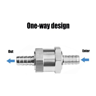

Maybe a cheap ($10) inline check valve instead?
