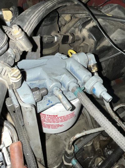

I used his guide to do mine as I pulled the pin and it stopped all fuel flow works good as “new” I have a 7.3 filter head and new filter I got for 7$ I’ve just have been too lazy
Austin86250
Oct 5, 2021
836
473
idaho
Just finished, do the 7.3 filter heads flow more? I got alot more fuel sitting out via the shreader than the 6.9 head
