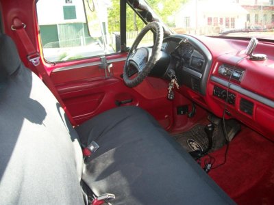

i pulled the bench out of my current reg cab f250HD (it was firm and i like soft) and replaced it with my previous trucks seat.a '96 f150 super cab (nice and soft/with a lot of bounce) and it bolted in just fine.i bolted up the '93's reg cab bench in the old '96 before i sold it and it matched fine as well.
here's a pic.it's grey,so i threw a low cost black seat cover over it.
though it tilts inward,the seat cover stretches enough to get behind the seat ok lol.
(its hard to find a seat cover with a full bottom and split in half back--for affordable $ anyway.so i said screw it hehe.)
